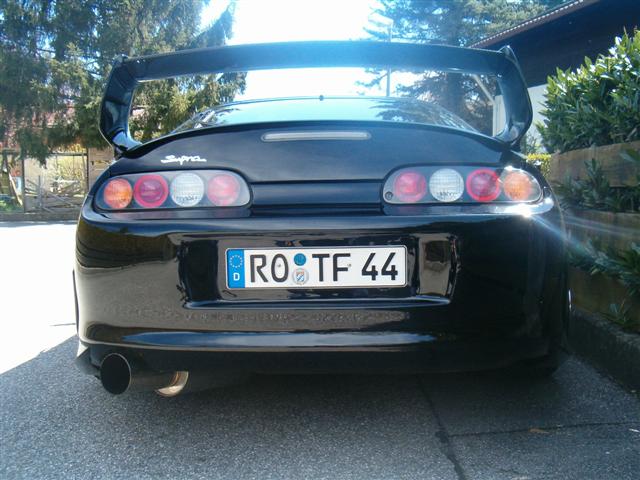

Black, sleek and stock bodied except for the carbon fiber TRD hood, this car, with polished OEM wheels, epitomizes all that we’ve come to know and love about the MKIV Supra. Owner, Ju-Hon Chan, graciously volunteered the use of this car for Clash of the Titans II long before the arrangements were made to acquire the various exhausts. Because of significant demands on my time, causing a number of unavoidable delays in the proposed competition, Ju-Hon used the intervening time to build up his car. Although the mod program has been comprehensive and balanced, our focus is, necessarily, on the motor, as these exhausts love to make big power.
