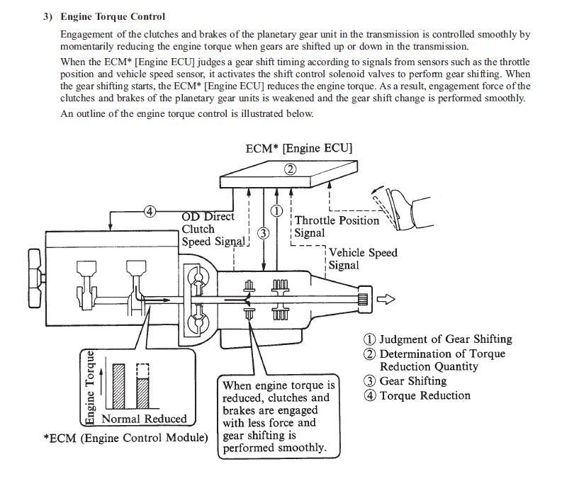

Was das Repair-Manual dazu sagt, siehe Anhang.

![http://img130.imageshack.us/img130/1958/repmanuala340e1.th.png http://img130.imageshack.us/img130/1958/repmanuala340e1.th.png](http://img130.imageshack.us/img130/1958/repmanuala340e1.th.png)
![http://img695.imageshack.us/img695/1232/repmanuala340e2.th.png http://img695.imageshack.us/img695/1232/repmanuala340e2.th.png](http://img695.imageshack.us/img695/1232/repmanuala340e2.th.png)
